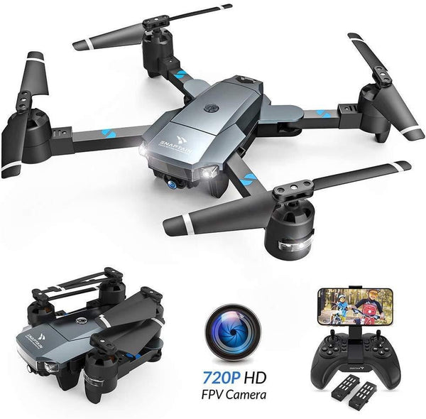

I have a vey basic drone which I picked up to get to grips with piloting a drone, to keep me and the kids entertained.
After a collision with a an object in my garden the drone will no longer take off (the collision was no worse than any other it has had whilst I have been getting to grips). Now when it tries to take-off it seems that lift is lacking on the back left rotor and instead the drone start to rotate/pivot on that corner.
I've tried re-calibration, I've inspected the rotors and changed them, and tried also swapping the the rotors with the corresponding front right rotors. On one occasion it appeared to be fixed, rose about a meter then set back down on the ground.
Any ideas what might be the issue, when the rotors are spinning the problematic ones do not appear to be any slower or different to the other 3.
Thanks in advance.
